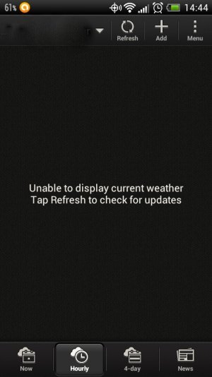

I have the HTC Droid Incredible 4G LTE that came pre-installed with AccuWeather's weather app. It also has the accuweather clock widget. This is the widget that has stopped working - the app all together has stopped working. I noticed October 3rd that it no longer updated. It still says October 2, 2013 with that day's high and low temperatures.

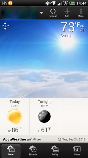

Usually, on the "Now" tab at the bottom of the screen for the app, it has the current temperature, the temperature for that evening, and the temperature for the following morning. However, it now only has the day's temperature for Oct 2, the evening temperature for Oct 2, and an empty block. On the "Hourly" tab, it states that it is unable to display any data and to refresh.

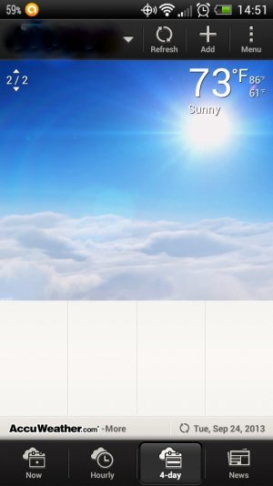

The "4-day" forecast shows the current temperature for Oct 2 and empty blocks at the bottom where the next four days should be listed. It also has at the bottom of each screen a refresh symbol and Sept 24, 2013 - whatever that indicates.
Today is October 8, 2013. Below are screen shots for clarification:

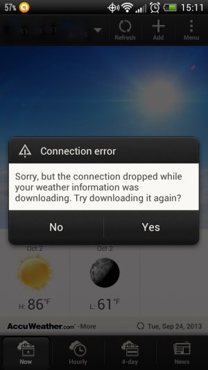

What it says when I try to update (with wifi on - connection is good because I can search the net) :
What I have done to try to fix it:

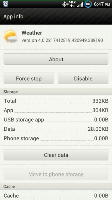

Try force closing and clearing data for both the weather app and the weather widget.
Settings -> apps -> all apps tab
Find weather (and weather widget)
Force stop. Clear data.
You will need to re-set up your locations and settings for both.
Sent from my Fireball using Tapatalk 4
Re: Accuweather Widget No Longer Updating
Thank you for the suggestion. I did a force stop and cleared data on both the weather app and the weather widget. However, when I restarted the app, there were no changes.
I also forced them to stop and restarted my device. It is still displaying the same as the images in the initial post. I truly appreciate your help in the matter, though.
