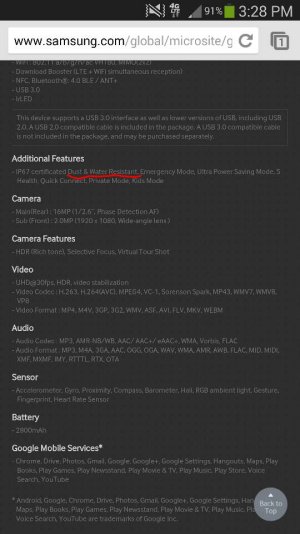

Screenshot below from the Samsung Galaxy S5 website.

Thanks for the info...even if it was water proof I never put in water...

There is no "waterproof" scale, there is an ingress protection rating in which the S5 is IP67 certified. The 6 corresponds to the dust resistance and according to the scale there is no higher value than 6 thus making the S5 dust PROOF. Regarding the 7 that the S5 scored, that is to certify it is capable of withstanding submersion in up to 1m of water for up to 30 minutes at a time, there is only one higher value (8)
above this which is basically water proof since it can be submerged in depths greater than 1m for longer periods of time.
Therefore, the S5 did not score poorly... it scored exceptionally well considering the S5 has a removeable back cover while other "waterproof" smartphones don't.

Sure it says "resistant", but the key statement is that it's IP67 certified.
That is what controlles the amount of water/dust resistance/proof technology has.
IP67 is slot more than just withstanding wet hands, rain etc. Have a look at the meaning and you'll see that the phone is in fact water proof in a way (30min - > 1m).

The S5 is IP67 certified. That means submission in water up to 1 meter deep for 30 minutes. That's a lot more than just "rain." That doesn't include water under pressure, though. Aim a firehose at it and all bets are off.
It's described as water resistant, rather than waterproof, for legal reasons. If they call it waterproof, someone's going to demand a replacement for a phone that sits at the bottom of a lake for a week.
All that said, there do seem to be plenty of S5's that have failed after less exposure than the IP67 spec requires, and Samsung has apparently refused warranty coverage on these. If I really needed to a phone that could withstand immersion, I'd get a waterproof case.
