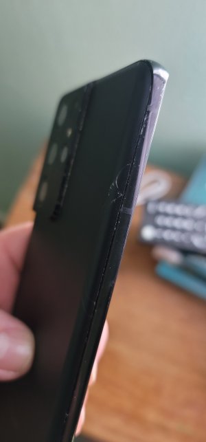

I don't know how exactly it happened... But it did. My son, who likes to play with my phone and has a tendency to play with water sometimes... May have potentially had a hand to play in this lol

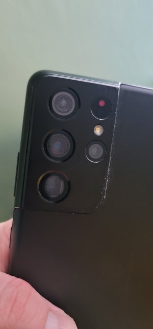

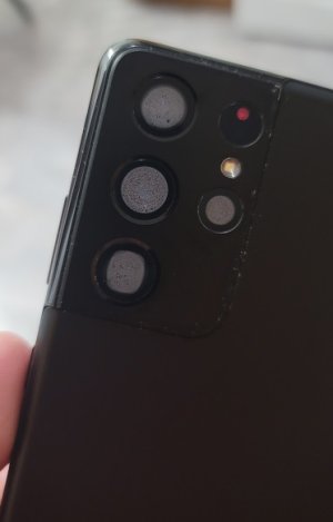

Any idea what to do? I was told the best solution is most likely to take it to a service center. Evidently, my device is no longer water resistant? I've had it for two years and never had any issues until now. I am also receiving the message that there is moisture or debris in the charging port. Oddly enough, other than these two things, it's working fine. But I'm worried that the camera lenses are ruined. I really don't want to take it to Ubreakifix after some bad previous experiences with them in the past.
I also tried using a blowdryer on the lenses to remove the moisture, and it worked for about a minute. The moisture/condensation appeared again.

Good ol' bag of rice! Unfortunately no way of knowing how 'big' a gap there is on the seal now (but yes, no longer water resistant) so gauging a time that it'll take to dry up may be difficult. This is very common on devices with even a smidge of humidity inside when temperature changes in the room or outside (think of those cars with fogged up headlights). This, of course, it's no guarantee that it'll completely dry but it should help should you decide not to take it to a repair center which, naturally, would be the absolute safest choice to completely fix this.

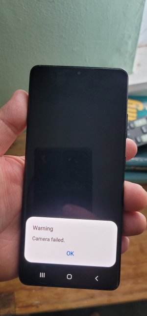

Yeah, yeah it does stink. But yes, the phone itself is working okay. I powered on the device for a short time yesterday to see if it was still working alright. The only issue I'm having honestly is the moisture in the camera lenses, that and the fact that when you try to start the camera app, it says camera failed...

That said.... I stuck it in a container of rice yesterday. Hmm. One of the lenses seems to have dried out. Idk if this is due to the rice, or another factor or what.
That said, I will probably take it to somewhere. I'm going to leave it in for a little bit longer to see if the other lenses dry out. Many people have told me my water resistant seals are worn out and I should look into getting it resealed. Funny, I've never had this problem before. Then again, I don't think there is a device that I've had since the S5 that I've kept for two years long, so perhaps they are worn out like suggested.

Well, the thing is, there is a crack on the back glass of my phone... Could it be possible it seeped through there that way?
The rice trick did not work. Or I should say, it worked for a short time. One of the lenses had no condensation in it... Then later on it was back. I can see the only way I can get this issue resolved is taking it somewhere.
The phone itself is still working fine. The camera is messed up, though. Every time I try to open it, it gives me a "camera failed," message. Looks like I'll be taking it to Ubreakifix, since evidently they are authorized Samsung service centers. Not really thrilled about that, though.. Since two years ago, I took my Note 10+ to one of them and they screwed up my device. Had a new battery put in and basically they didn't put everything back together right. I'm guessing some of the connector cables were loose in some way, because after that, my display would regularly turn green.

use a hair dryer on low heat (you can put the dryer a little far) onto the camera lens this will help evaporate water inside, it can take couple of weeks to dry without anything too
If the 'rice trick' worked and humidity came back, it's very likely the seal is just done for. You can keep drying it, but humidity will keep seeping in (and with temperature changes, condensation will keep happening and potentially be wet enough to short things out at some point).

I'm guessing it had a lot to do with the fact that my phone was cracked at the back.
