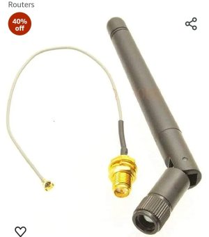

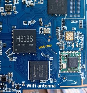

I found a solution may be works for you.
First of all,
1) Open tv box.
2) Find wifi chip and antenna type.
"In my case, you can see in image"
3) Solder a piece of wire to that antenna
4) Buy or Pick from old router or DIY from yt tutorials of wifi antenna.
For reference, I attached another image from Google.
5) Now attached that wire to wifi antenna
Now speeds will improve for sure.
"In my case, I soldered 40cm plane wire to antenna and that's it . Tv box wifi speed before this trick is barely 1-2 Mbps. After this trick, Getting around 16-17 Mbps."
If you have this wifi antenna shown in second image then it gets better. For me, I just left a plane wire soldered.
