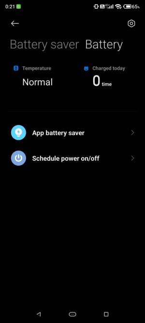

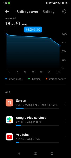

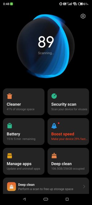

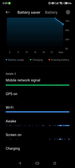

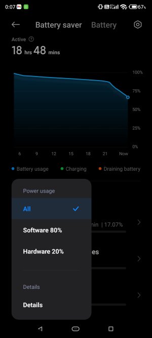

Open the Security app and let it run it's clean up sweeps for all the areas highlighted.
You should be able to pinpoint where the problem is. I need to remind myself the best way to do that so I might post again! 🤔
Also at the bottom of the Security app try "Solve Problems" which includes a battery check.
