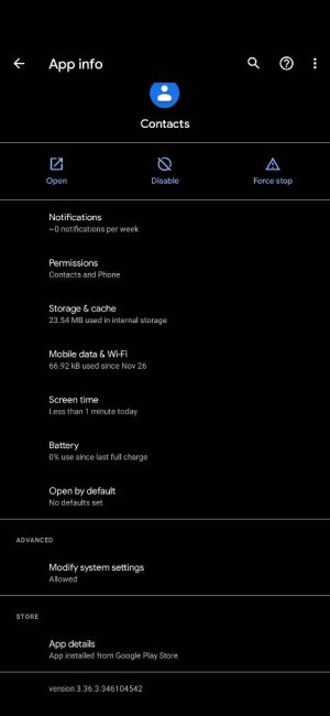

That might be the Motorola contacts app, the Google one has a lower version number.Screenshot_20201224-104312.jpg
Hmm, so no option to Export anywhere? That's really the main way to do this -- export the locally saved contacts to a CSV or VCF file, and then import that file into Google Contacts.
