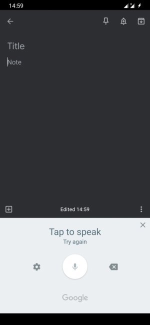

Hmmmm. Tried offline speech for the first time and it didn't work. Android 10.

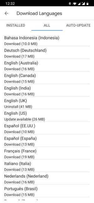

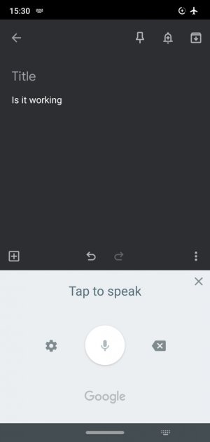

Ok, I tried with the Moto G7+ running Pie and it's working. After I ran the test went to the Play Store and there was an update for the Google app, updated it and it's still working. The only difference I can find in the settings is that in the G7+ i have English (US) as system language and UK in the OnePlus 7. Which system language do you have?
