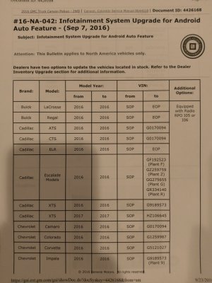

Not sure who this may apply to. I had an Smasung S7 Note and Android Auto stopped working so after a couple of months of research I found the change in the GM code for Intelilink Infortainment systems.IMAG0008.jpg
