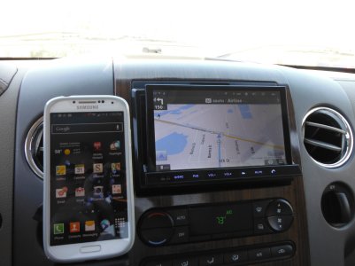

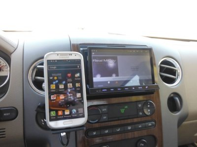

For those who were following my experiences with this unit. I DID get Google Voice to install on the pad just a week or so after install, it is just not available in China so I had to find the .apk file and just load it on the SD card to install. It has now been well over 1 year of daily use (still at android 2.3.5) But voice control makes this thing a whole new beast. I call out addresses and Google Navigation gets me where I need to go. I also answer e-mails, etc. hands free while driving now. I know you can do these things on a phone but having a 7" screen that is stable on the dash just really makes reading e-mails and using Google nav. easier. Here is a photo of what my view is from drivers eat now that I have a wireless phone charger mount for my phone as well. The ONLY thing short of perfection is having to turn on wifi hotspot every time I get in the truck and realizing that the Samsung S4 wifi hotspot is no where near as stable as the Motorola RAZR one was. This hurts for apps with little buffers like IHeart Radio but Pandora is still fine. I may get a usb sim card wifi device I seen on Erisin website and just add a line for $10 to get a permanent 4GLTE signal.... if it works.
