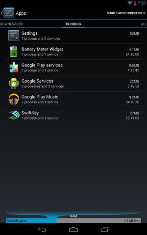

Re: Android Is Battery Usage
What do you have running in the background?

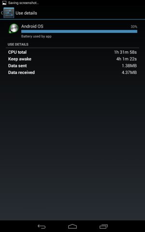

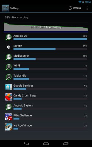

Here are images of the issue and what is running in the background.
If the forum embeds don't work, visit the links here:
https://www.dropbox.com/s/wzcennazhfbcxlh/Screenshot_2013-08-07-22-55-11.png
https://www.dropbox.com/s/o0hijzn5ziq00dd/Screenshot_2013-08-07-22-55-16.png
https://www.dropbox.com/s/l80wsr5616dfap2/Screenshot_2013-08-08-07-50-14.png
Any ideas? Screen time is ~2 hours.
Hopefully these photos make it easy to see the issue.
I've not seen that kind of usage before. If it was mine I'd do a factory reset. Decline letting the install add previously installed apps. Then I'd check it again. If that doesn't change it to normal usage, I'd exchange it.
If it is normal after the reset, I'd start adding my apps back, one by one, checking usage on each one until I found the problem.
Sent from my incredible new Nexus 7 (2013)
Thanks for the tip. I may try that. I guess I need to re-lock the bootloader if I need to exchange it, right?
Update: After security wipe things seem to have settled down, but I have not restored all my apps yet. I will add one by one over time and see if there is an offender. Thanks for the tips.
