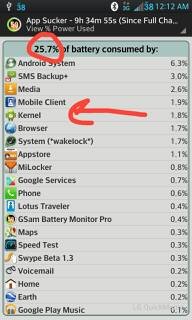

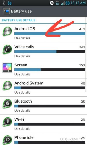

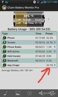

It appears that LG has decided to write their own battery use app, forgoing the standard android one. This seems to be happening more and more with different vendors.
I just got my lgog yesterday, so am still experimenting, however suffice it to say that lg's implementation of the battery use app is not very good.
I've attached two screenshots from GSam battery monitor (yes, I am the author) compared to the LG one. GSam names the android os as kernel, but notice the huge difference.
Not to toot my own horn, but in this case, GSam has it right :)
Sent from my LG-LS970 using Android Central Forums

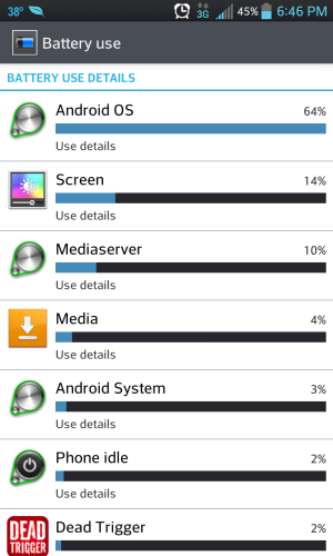

Just got my AT&T LGOG 3 days ago, and have to agree with others that battery life is "iffy" at best - Android OS is my highest battery hog at between 60 and 70%
