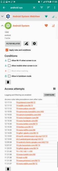

Now just to make things more interesting, I have "Android System" blocked in my firewall. And my firewall logs all of the internet access attempts.
Can someone please explain to me, what, Android System would have to be constantly attempting to contact the addresses you can see in the attached image?
To me, that is very weird, to say the least....
P.S. This was a scroll-capture, so I hope it all shows up here, otherwise I'll have to edit it...

Ok, I'm not sure you can see the fun parts, so I cropped them out, and here they are.
I don't even use ANY of the web pages on this list! What is going on?
Would be an app that uses a services of Android System. On a Samsung I would expect that from Daily Briefing. I disabled that.
Holy ****, you're right! What else would be contacting all those sites!
I'm disabling it right away! Then I'll be watching the battery like a hawk!
Thank you so much for this! I hope I'm not expecting too much, but I'll report back with the results...
What confuses me is, that Briefing is a separate app, which still works, even if Android System is blocked in firewall. Why use Android System services at all, is what I don't understand.
I kinda liked it, but didn't use it lately anyway. It's disabled now.
However, what is "Daily Briefing"? Is this another thing, or did you just mean the Briefing app?
Unfortunately, one day after disabling the Briefing app, "Android System" access attempts still look practically the same....
Why on Earth would Android System services need to be contacting these websites, none of which I ever even use?
