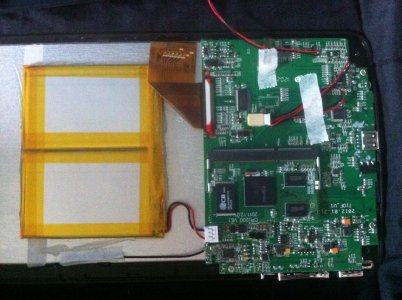

I recently received an Innovatek Inno Pad 10 (chinese android tablet) as a gift and the problem is that the tablet does not boot up. When I got the tablet and turned it on, it showed me an android bootloader screen and then it brought me to the android logo boot screen where it would basically go into an infinite boot sequence. I have tried charging it fully and then turning it on, I have tried un-plugging the battery and plugging it back in. I even tried re-flashing the firmware on the device using a software supplied by the company (it was very hard to find and the company's support is not that great). The flashing process was completed successfully but the tablet would still go into an infinite boot loop (I even tried re-flashing it again with no luck). Here is the worst part, there was a u-boot-nand.bin file included with the program and I decided to try and flash the tablet using that file. Now the tablet's screen won't even turn on, but the power and charge buttons still light on. I think the bootloader got messed up. Does anybody have an idea how to get this tablet working? I have posted pictures of the tablet and its specs.
