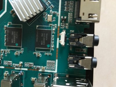

I purchased three of these media boxes in an estate sale...
their is a tactile switch behind the A/V jack..
I was able to get what I call a "BootLoader" menu when I hold the tactile switch in with a Toothpick... then insert the power plug and hold it for a few seconds... then release the toothpick and let it boot up...
This should help you validate the unit can do this Cold Boot to a BootLoader screen...
My issue is with loosing the whole network... wired or Wireless...
I will need to figure out if I can load another image from the SD card on Bootup... or use an external USB network device...
thought I just wanted to share what I'm doing

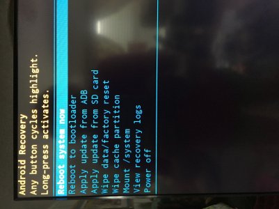

Good Day,
My Android TV box is stuck on the pic below:
I have followed a few youtube instructions, but it still does not reboot.
I have done a factory reset, clear cache, mount/system and then choose the option to reboot.
It goes to an android screen, but then opens on this screen again.
Please help

Good Day,
Please help
Did you ever fix this problem as a friend of mine is having the same issue ?
