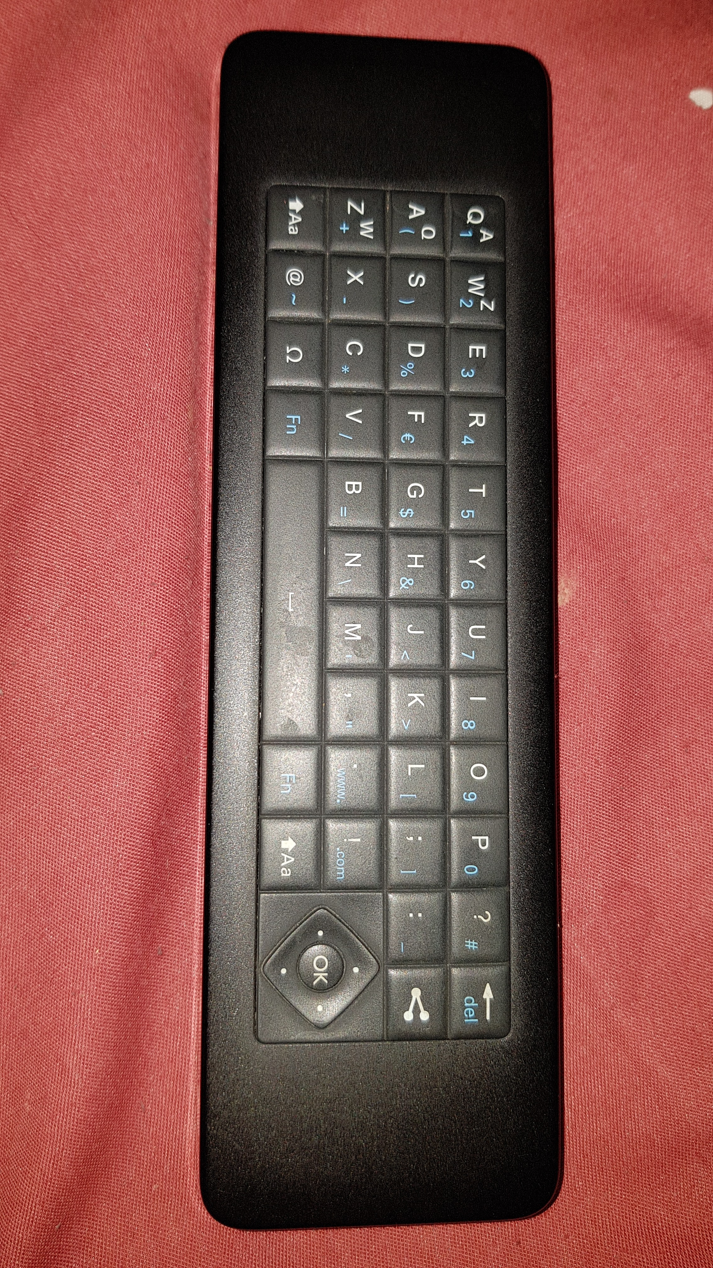

I know that these tv's have at least one hidden menu and would be very interested to see what other options are available but all the articles I've found on the web which show the codes feature slightly different models and different remote controls than the one I have.
My remote (front)
My remote (rear)
