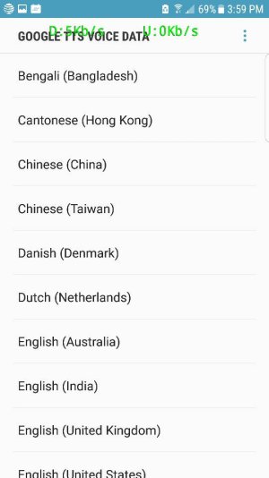

About a week ago I started to get the above popup. It displays all the languages available. If I select English (United States) there is no download icon so I know my phone already has it. Any other language shows the download icon. I exit out of it and within a few minutes the same popup appears. it does this periodically throughout my day.
Any idea why this is popping up and how do I stop it? My phone is an ATT GS 7 Edge on Nougat.
Thanks

Re: Google TTS Voice Data
Here's the popup

Yes I am having the same problem and do not know how to fix it. Had hoped there might be an answer here.
I had really noticed it when/after I had installed a "Call Announcer". Thinking, I do that once in a while, that I need to remove the Call Announcer and see if the problem persists. Will get back on this...
-Chuck
Well, guess what?? I removed the call announcer and the problem went away. I haven't had that annoying problem all day since I removed the call announcer. I will monitor it for a couple of days without and with the call announcer. One of the requirements of almost all of these announcers is that Google TTS be installed.
Oh one more thing... I didn't have this problem with Marshmallow.
Well, another thing. It is NOT a problem with all Call Announcers. I have installed
"Call Announcer Pro" and it does NOT cause the problem.
