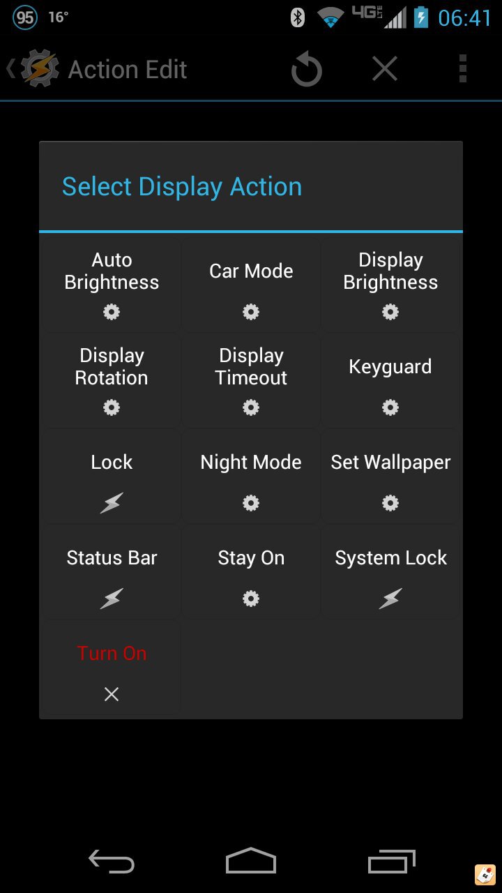

So I use tasker and I can accomplish an action when I shake the Sven but this us what I get when I try to tell it to turn on screen, see attached photo. The red and the x mean the phone does not support and I am rooted
