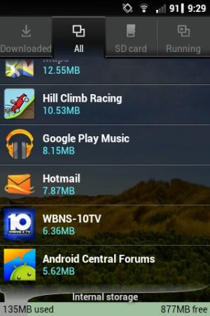

I have 58 apps downloaded and installed with no internal storage used.View attachment 44636
Would this be better than using link2sd?
Sent from my LG-VM670 using Tapatalk 2
Some would say yes, some would say no. The difference is minimal but for me I like using this one because it makes my widget display the space properly for internal space.
