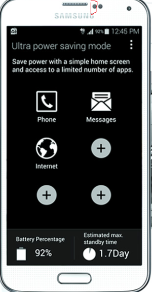

It was in this sensor.

Re: Galaxy S5 : Red Light In Sensor
I notice you are in Ultra Power Savings in that image and with 92% battery charge your image shows only 1.7 days left on standby. Mine is at 94% and shows 11.70 days left on standby.
Something is wrong aside from that led light in the upper right. Call your carrier or Samsung tech support.
I agree. But that light from the proximity sensor is worrying me. I know one of those holes is an IR EMITTER, and the other is an IR RECEIVER. But the key is that it's infrared. You shouldn't be able to see it at all. Perhaps you have superhuman vision? :-D
