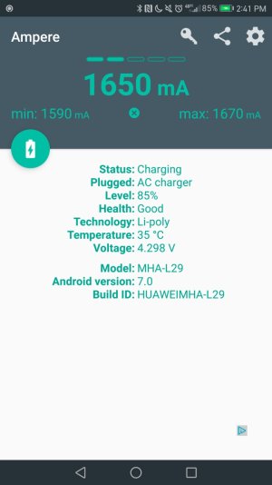

Thats odd that your Aukey only got 1680. My Anker hits over 2000, highest Ive seen is 2400. Maybe it being a car charger is the difference. Definitely the Huawei chargers and cables are faster but you can still get some nice speeds from the QC 3.0 devices as long as you use a Huawei cable. Ill be very curious to see tomorrow if the Huawei Quick Charger I ordered shows fast charging on the lockscreen as Ive yet to find a charger that will even when getting fast charge speeds.
This is with that Aukey QC 3.0 car charger and its included cable in my Volkswagen.
I'll try it with the Aukey cable next time I get out in the car.

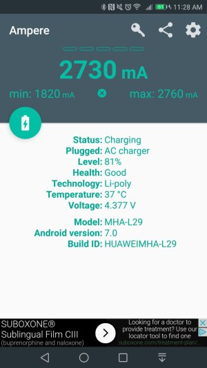

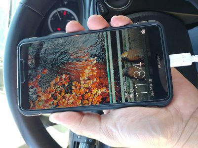

I bought a USB c with power delivery (pd) car charger and it triggers " fast charge" in my mate 9.(only in usb c pd not Qualcomm quick charge port)
It adds the second lighting bolt in the notification bar and also says "fast charging" on the lockscreen.
I took a couple of pictures that I am attaching.
Fast charging is not the same as the super charge correct?
It does charge the phone faster though.

Now I have to decide if I buy ANOTHER car charger. I tried the Anker QC3 charger mentioned somewhere on here and it did nothing special (checked with Amp app).
Maybe it's my 2010 VW. What year is your car?
