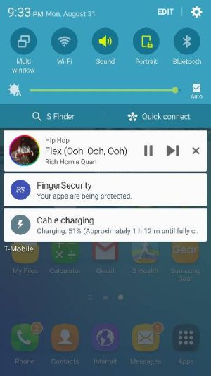

Anyone having problems with fast charging?
Noticed issues as well. But I do have a Note 4 charger here, and I think I was using that one. As soon as I swapped the cable for a more recent one by Samsung... it worked. I do think it's an issue with certain cables...
Hmm, just started having the same issue. Using the stock s6e+ cable and charger. I have to reconnect several times to get the fast charge.
Hi all, I had this issue for a long time, ever since I got my S6 Edge Plus on release day. I never took it back because randomly it seemed to work. As someone previously mentioned, if it works in the store, you'll take a lot of crap before they'll return it. In any case, strangely enough, If hit the background app button and then "close all" of the background apps, then plug it in, it will fast charge. This is the stupid problem to have... but that's been a fairly reliable workaround in my case. Hope it helps!
EDIT: I'm on TMobile variant btw
I just use a different cable an my fast charging works just fine now
I recently updated my edge + since i got the notification for system update, when the phone was done with reboot, I charged it and showed cable charging only. Called customer service, was advised to restart phone, and then it was fixed, it shows fast charging now, however, after a few minutes it showed cable charging again. Tried different wall plugs but still the same thing until i decided to change the cable, that did the trick.. shame on the cable thats less than 1 month old compared to the one im using now which is a year old..

I plugged in the charger from note 4 that has fast charging. On my s6 edge plus It shows as cable charging only. I plugged the charger back into my note 4 and fast charging comes up with no issue. Any idea is there a setting I'm missing. This is T-Mobile variant by way.
