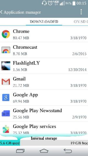

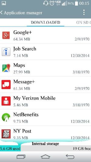

Anyone know what caused this
mrip
Active member
Apr 17, 2013
41
The dates for all Google and Verizon apps have changed.
Dates re stored as Unix timestamps, where 0 = 00:00:00, January 1, 1970. I suspect that all the dates got truncated to very small numbers. No idea what could have caused it.
