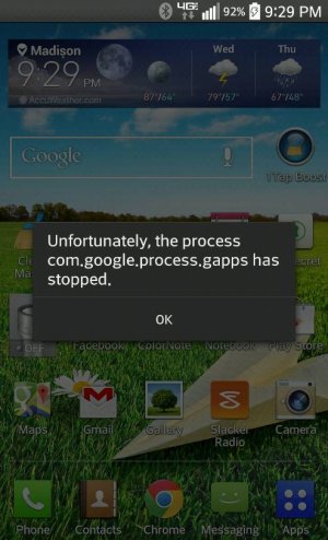

Ever since I upgraded to KK I've been seeing this message after a (power off and restart). Anyone know what it means?
Thanks in advance!

There is probably a cache error in the new ROM. You can try going into Settings>Storage>click on cache. That should clear most of it, and hopefully, the system cache as well.

Do you use Swiftkey, Google Keyboard, or another third party keyboard? If so, remove it and this message will go away.
Yep. Known Swiftkey issue. It doesn't seem to affect any functionality.

There are no updates yet that can fix this. It requires a fix from Swiftkey that isn't yet available.

I get this everytime I restart my phone. I do use Swiftkey. I have been having quick battery drains and sluggishness as well. Could this all be related to this? Also my messages send very slow and my phone gets really hot. This never happened before the kit kat update.

I get this message frequently after a reboot as well and I also have Swiftkey.
I also use swiftkey but this above worked without having to do anything to swiftkey.
I had this problem also. If you switch to SwiftKey beta the message dissappears. SwiftKey beta is every bit as stable as the normal SwiftKey app.

Thanks a lot guys! And yes I do use "SwiftKey" and I'm glad that it seems like it's not causing any apparent issues.
