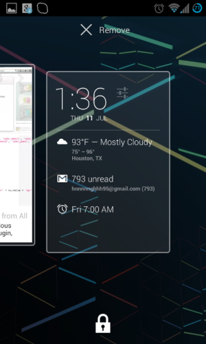

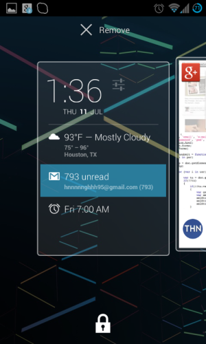

Then, long press Dashclock until you see this:
Bring the window contaning Dashclock to the far right:

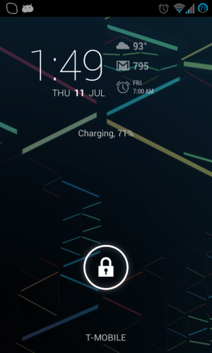

..and you should end up with this:
Alternatively, you can long press any widgets present on the lockscreen, swipe them up to delete them after the long press and add Dashclock so it will be the first widget screen going from right to left.
Hope this helps. :p
Hope this helps. :p
