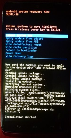

I've encountered the dreaded "Unfortunately, System UI has stopped" pop up which renders your phone useless. It came about by accidentally brushing over "Force RTL layout direction" in Dev Options which has a bug in Lollipop. I didn't get a chance to enable "USB Debugging" So I can't access the internal storage.

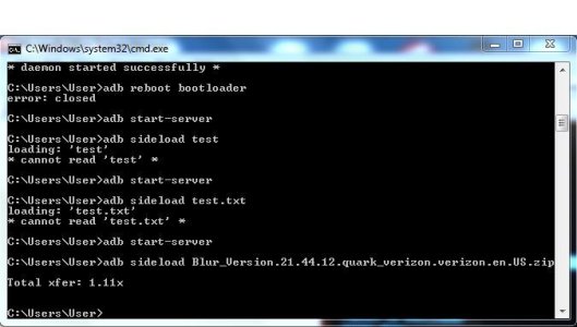

I was thinking if I could reinstall Lollipop (I already downloaded the OTA ROM) and updated it again through ADB it would reset the Dev Options and fix the issue.

I'd Google House of Moto, which will optionally let you flash without overwriting data, but you'd need the fxz of the lollipop update and it's entirely possible that the developer options setting is in the data partition so not overwriting data will not help you.
It's possible that factory data reset is your only option. And never turn on an option in developer options unless you're a developer or absolutely know what you're doing.
