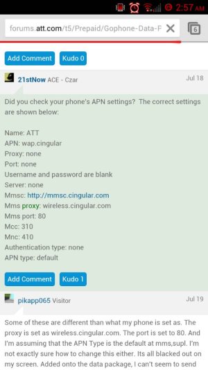

Anyway, AT&T put exactly what grenefroggie listed in my APN settings except for the APN Type; they left that blank. I think my error was using " \\ " instead of " // " in the MMSC setting. The AT&T rep sent a picture message to me and it came through fine, but my phone won't send a picture message to his phone. After a half hour of trying with failure after failure, the AT&T rep suggested I take the phone to the cell phone repair shop three doors down and have them set it up properly. He said they know more about this stuff then we do. Again, WTF!

Just tried adding the APN Type: "default,supl,mms" (no spaces) that grenefroggie listed above and that didn't correct my problem either. Still can't send picture, but can receive them.

Try using this APN. I got it straight off the AT&T Prepaid Forum. Create a new one a d make sure you select it, then reboot the phone.
Then check if you can receive picture messages as well.
Nope, that didn't work either. Because the error messages are "MMS not supported by network" and "Server response error", I'm thinking it might be related to the block of phone numbers that my number came from. They are registered to Blue something, now a subsidiary of AT&T. Maybe going through "their" network is somehow an issue that requires something special???
