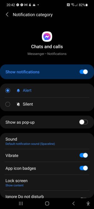

Can you customize the notification tone for FB Messenger? I think that was also not possible for a while, but hopefully they changed that as well.
For Text messages, open your Messages App, tap the 3 dots for Settings, tap the Notifications bar, not the toggle, then the General Notifications bar, and you can change your sound there. I just did that.
Yes, you can. Tap the Avatar at the upper left, by "Chats," then Notifications and Sounds, and "Customize Notifications" to get to that setting.
