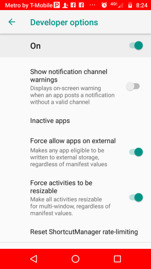

I thought the setting in the screenshot was the culprit, but it wasn't.
