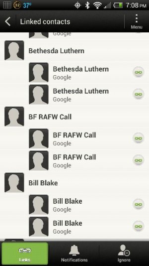

Here's a strange one I came across. Seeing very slow performance in People app, especially when clicking on a contact to dial. Looking at "Linked Contacts" I see that ALL my contacts from Google are appearing twice (they are automatically linked together, but still something fishy).
