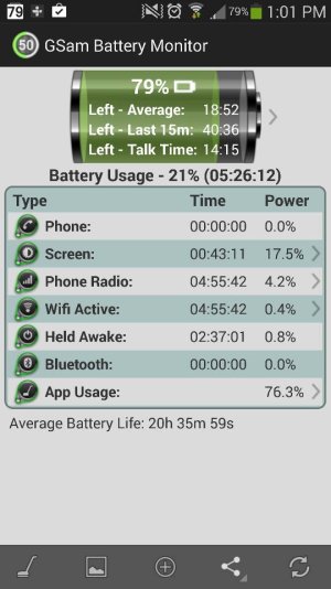

Got the phone last Friday and I was getting killer battery life over the weekend getting over 4 hours of screen time and was going to bed with 50% left in the tank. Now this week it seems like the battery is getting worse and worse. I do work in a basement and get 2 bars so I am hoping that's the case but I have wife on auto brightness on NFC off bt off 4G lte on power saver on Samsung gimmicky apps like eye scroll and such off.
Do these stats seem right? Unplugged at 7:30 this morning. 79 percent now. Five and half hours of battery and 43 minutes of screen time
Does they seem low or do you think it is the mediocre cell service doing me wrong
Sent from my SAMSUNG-SM-N900A using AC Forums mobile app

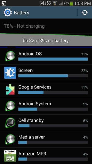

Also here is a screen shot of the battery usage a few minutes later 1382548192006.jpg

Auto brightness is actually bad for battery. The sensor has to constantly sense the light in the room. To adjust if needed.

Same here. I had my note 3 on the 3rd and was getting killer battery life as long as I was on wifi. On avg I was getting 8 hours of screen time and was only at 10% battery life left. I even got 10 hours screen on time before hitting 1%. But every since yesterday I've been getting horrible battery life. 3-4 hrs of screen time and I'm at 12%. I'll do a reset tonight also. PS my power saver is off and all the gimmick features are off as they always were.
Phone is dead after only 10 hrs on battery with about 2.5 hrs of screen time. I gotta figure this out.

I've never had the OS using more battery than screen. Screen is always top of my list unless indexing service is running. You probably have a rogue process or something is still enabled that is really using a lot of battery.

Well I haven't changed my screen brightness setting. It was always on auto. I'm not going to any new places that would have a diff/weaker radio signal. My bars are always around 2-3. But I was getting great battery life. Last night my ohine died and I still had 4 hours to be at work. I usually have 30-45% battery left at this point. One thing I've noticed is that it doesn't matter how much or how little you use the phone; the battery will last the same amount of time. I usually get between 16-18 hours on battery before she dies. I coukd have used it heavily (8 hrs of screen time, mostly downloading apps and surfing the web) or hardly (2-3 hrs of screen time, web and email) the phone is still dead around the same time each night.
ATT N3
OS just recently started using more battery than my screen the other day. Still trying to figure out why.
I figured it out. It was myfitnesspal wedgit that was draining my battery. Back to great battery life for me.
