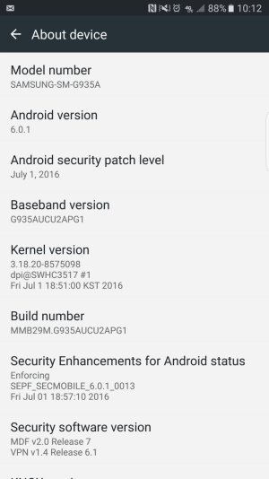

Hey all,
My AT&T S7 edge downloaded the most recent update a few days ago. This is my current build:
Ever since my phone updated, my bluetooth is sporadic at best. Often times, as soon as I toggle it on, it immediately toggles off. Sometimes it will be on, connected to a device, and randomly shut off. I force stopped Bluetooth Share and cleared the cache multiple times and have done several power cycles over the last few days.
