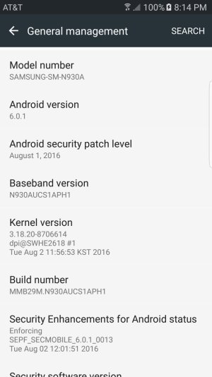

check your baseband version and see if it matches this. Should also have August security patch level after update.
Mine says my software is up to date. 6.0.1
My patch level is dated July 1! Still no sftware update notice!
