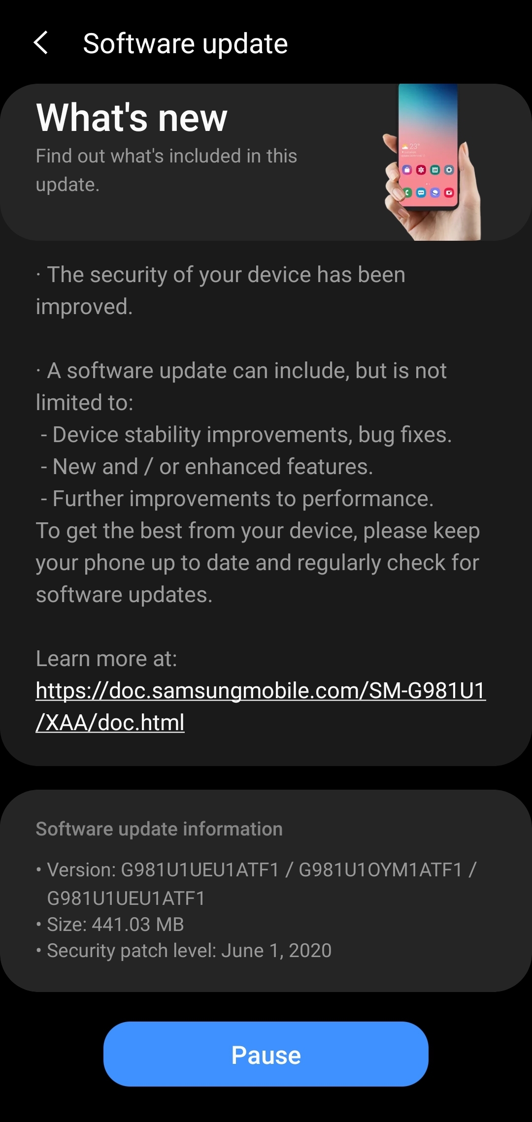

Downloading the new update ATF1 on the US unlocked model. Previously I was ATE6 with June security patch. But there is a trick!!
Supposedly the new update is out for the US unlocked model for XAA meaning if it's not associated with any crappy US carrier. I'm using it with T-Mobile and checked update (nothing). Then put my old Verizon sim, restarted to associate with Verizon and still nothing. Luckily I had an international SIM from my past travel and put that and restarted and checked update. Bingo !!!!!

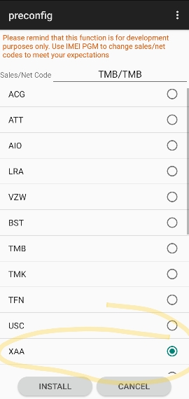

If you don't have an international SIM lying around you can try below method on your US unlocked model. And no if you have a carrier model this won't work since your carrier model is running specific carrier firmware and this is for the US unlocked model to pull the unlocked firmware update without waiting for useless US carrier certification crap.
1. Remove current SIM - important and don't insert it back until update is completed.
2. Open Dialer and Dial *#272*IMEI# (you need to replace IMEI here with your actual IMEI number)
3. This will bring up the preconfig menu where you can associate a carrier code.
4. Choose XAA, and install
5. In select type of change, select sales & network code change.
6. It'll restart, once restarted check for update to pull ATF1 and install update.
7. Once update is installed completely, you can put your original SIM back, it'll restart to install your carrier configuration and life as usual.

For record I was able to download straight to this version without removing my VZW sim. Screenshot_20200614-101654_Software%20update.jpeg

Thank you Sir bhatech!! Did it without the SIM on my US Unlocked Ultra. Followed the directions exactly, and it was a walk in the park.
