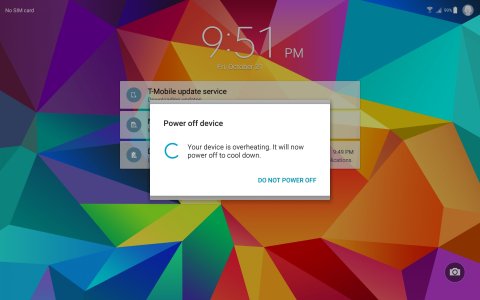

From what I know, two black wires are negative, two red wires are positive, two blue wires probably for temperature sensors. From my experiences when resoldering this connector, two pins connected to blue wire if not soldering properly or damages ( broken trace ) will cause overheat problem like this
