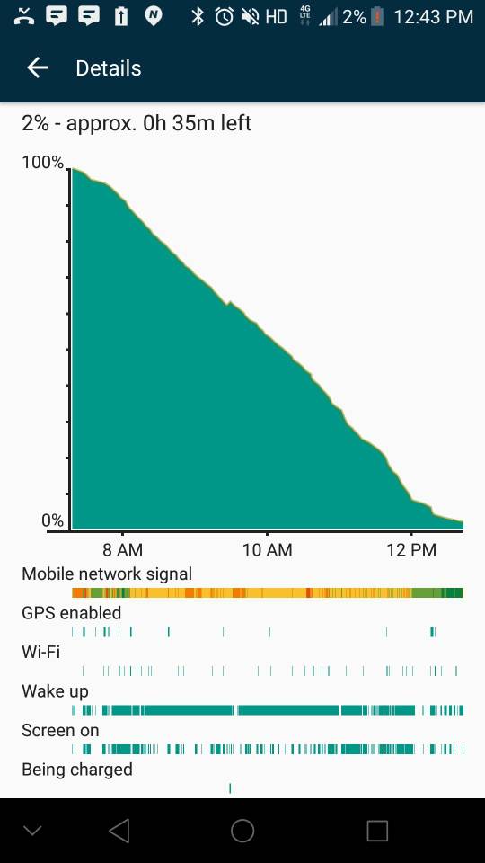

My friend just got this phone and it seems to be Draining battery pretty fast. What's the average battery life you guys are getting out of he mini? I have the regular axon and I think it does ok but I know the mini has a smaller battery and lower speed processor. Is there anything that can be done to help the battery life last a bit longer?
We've cut off sync, went through power manager to limit some apps. Any suggestions?
It'd help to see some battery stats from your friend, since his use won't be exactly the same as yours. For example, he might be in an area of worse cell signal, which can kill battery.

This was one older screenshot from before I adjusted a few settings in power manager on the phone
Can you show more of the screenshots I had recommended? It helps to see more information. The main thing I can see right now is that there's a lot of yellow in the cell signal strength, which is mediocre -- that can increase battery usage. There's also a lot of Awake time, so that might indicate some app that's inappropriately keeping the phone awake (although this can be hard to pinpoint).
