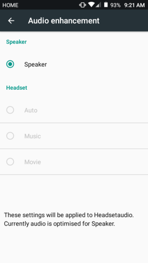

So after reading my question there was some awkward/poor phrasing so sorry. I did go in and try YouTube and SoundCloud again. SoundCloud worked fine but YouTube didn't and I'm questioning if it even did before. Either way the fact that one of them has good audio is enough. I placed a few files back on the phone to try and there was also no change in quality. So I have a few ideas and questions. The fact that audio is good with one app leads me to believe this is not a hardware issue like the aux jack itself. That said when plugged into the car the phone goes into headset mode which does change audio optimization. I will include a picture of what I am referring to (the screenshot is when not plugged in an auxiliary connection and changes to "headset" when it is also allowing choice between the 3 options). Could this be the culprit? Is it worth contacting Alcatel about this or will that just turn into them saying to hard reset the phone and getting nowhere? I am going to try some other apps to see if anything changes, maybe I will get lucky on a music player that works someway.
