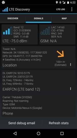

Maybe a dumb question, but I can't see how to tell if you have band 12 on the app LTE discovery? All I'm seeing is band 4. I'm in Tampa with a strong LTE signal on T mobile. Thanks, guys.

This is a picture I swiped from another board that shows Band 12 displayed on the LTE Discovery App. Note the person that provided the picture even had a Nexus 6 listed at the bottom. LTE Discovery is only going to show you the Band of spectrum your phone is connected to at that time. Note Tampa area must have about a 100 T-Mobile cell transmitters like Fort Lauderdale/Broward County does. So you got a lot of driving and searching using just LTE Discovery. A single Cell towers has two, three or four cell transmitter units that each point in different directions where on one side of the tower you would get Band 12 and on another side you may just get Band 4.
Spectrumgateway shows at least two T-Mobile sites on their 700Mhz map in the Tampa area that have been reported months ago. The best way to find these T-Mobile 700Mhz cell towers is download the Cellmapper App and contribute data as explained on their cover page. I only turn on Cellmapper when I am driving around so it doesn't waste my battery when I not in my car uploading new data. I have used Cellmapper to cover Broward County in South Florida that shows the entire T-Mobile cell Tower network by bands & coverage direction. That you can click on any cell tower you find and get the information on that tower like I did here.

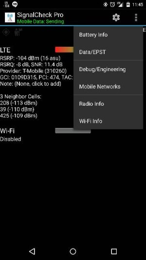

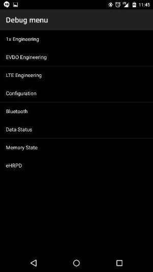

You can also dial *#*#3282#*#* into the dialer and then tap LTE Engineering. That will tell you what band you're on.

I see LTE and LTE-Available. I do not see LTE Engineering. Nothing in that menu shows me what band I'm actually ON.
Please elucidate further.

It may be faster to install Signal Check Pro. It has a shortcut that goes straight to it.
