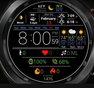

Technically worse because my Facer watch face gives all of this info:

I might just give it a go. Using my favorite Facer watch face, (pictured in an above post), lasted a whopping 11 hours today. :'(

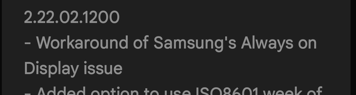

I know my watch faces issued a update for something, it was a work around for Samsung watches.

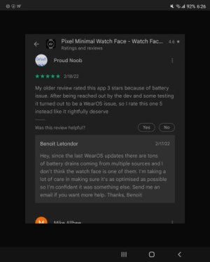

Here's one of the watch developers responding to someone about battery drain on GW4 since the update.
