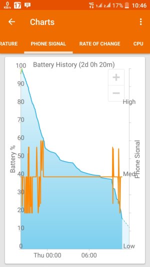

B. Diddy Senior Ambassador Moderator Mar 9, 2012 169,678 11,089 113 Apr 19, 2018 #21 The Phone Radio is using up a substantial amount of battery, which could be due to poor or fluctuating cell signal strength. As previously suggested, show us the Cell Signal Strength graph.
Ansuhail A Member Apr 15, 2018 17 0 0 Apr 19, 2018 #22 Phone signal graph Attachments Screenshot_20180419-104649.jpg 113.4 KB · Views: 5
B. Diddy Senior Ambassador Moderator Mar 9, 2012 169,678 11,089 113 Apr 19, 2018 #23 Yep, it's your cell signal. See how the battery curve is steepest where the phone signal is fluctuating into the lower area?
