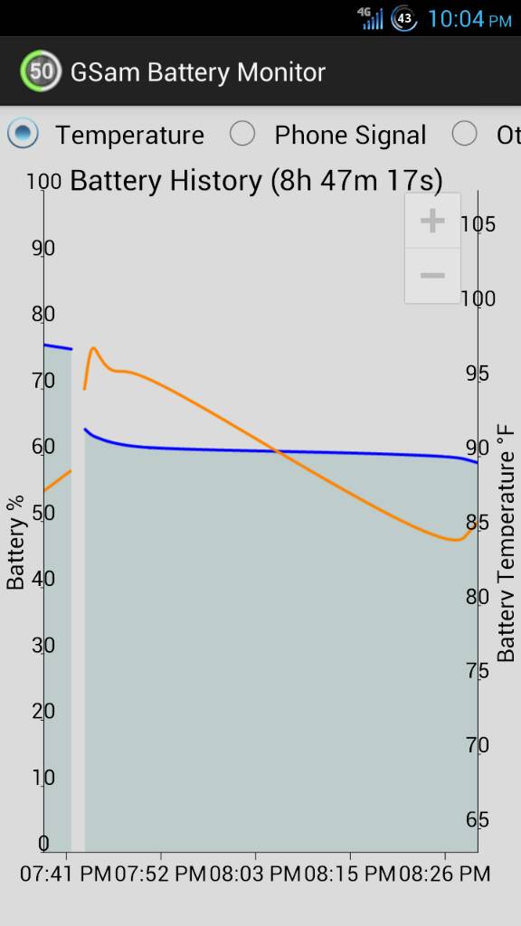

This is what happens when I just reboot. The battery was down over 10%.
Sent from my One X using Tapatalk 2
