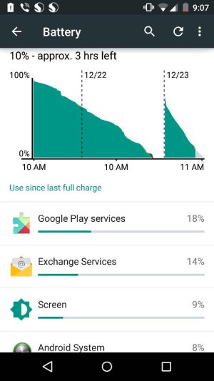

It's a laugh isn't it? I sympathise because I've had, and continue to have, battery problems on all my phones. Lumia 1020....worse battery life after WP8.1 update. Nexus 5...worse battery after Lollipop update. LG G3...worse battery of late, coincident with nothing, unless it's colder weather. Lumia 930 okay, but here's an good one-off to make you laugh....an overnight battery drain from 100% to 3%, phone actually powered off to protect the battery. After a while you lose interest.
But excuse my gloom. What do your battery stats reveal to be the app or apps responsible for the drain? Also, are your sync settings okay, and is your location reporting, if On, set to battery saving mode?

There's no apps that stands out as a battery hog - Kernel & Android System are by far the bigger users.
Overall Wifi used 46% of the last stats, but then that's on all the time.
GPS is off and location is on battery saving. NFC is off, BT is off..

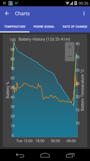

Exactly the same stupid bug after updating to 501. I start to wonder whether I belong to google developers team or not...

Not had a chance to follow this up properly yet but I have seen an improvement after disabling the syncing of email every 15 mins overnight - it does this all day, but I'm wondering if a weak wifi signal at night is causing extra grief...
