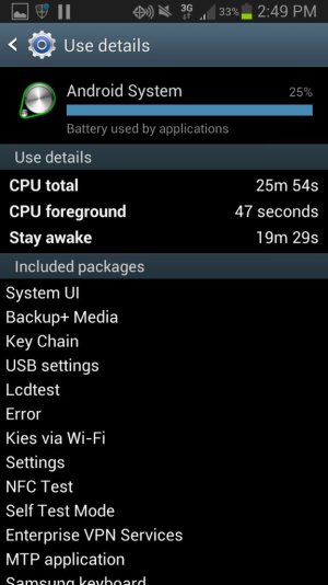

Android system is a catch-all for a lot of processes, and it's not very helpful in figuring out what's going on. So far, I've only found one app that will show you at a detailed level what is using cpu, which is a pretty good proxy for battery use (other than screen and radio). That app is System Panel: https://forums.androidcentral.com/e...panel.r1&feature=search_result&token=z85SnxKR..
The paid version (2.99) has a monitoring function that runs in the background and shows at a very detailed level what's going on over time. Some of what follows may work on the free version, but I'm not sure.
Go into the app settings and check App CPU monitors, App CPU Time, and System processes. Then take a look at all the apps and processes that are using up cpu. Scroll all the way down to the bottom section of the app list, labeled "internal system processes," and you'll see the things that make up "Android System." Tapping any one of these rows will display a page with even more detailed information.
Earlier this week, my SG3 suddenly went nuts on battery, losing about 40% of full charge just sitting, unused, over night. 20% is more typical for me. Using System Panel, I was able to track it down to the QOSMGR service, which was using more cpu than everything else combined. If you're having any kind of device performance issues, System Panel is worth it's weight in gold. Hmm, apps don't weigh anything, so I guess that old expression doesn't work here. But it's well worth the $3 asking price.
Some Google searches turned up some links indicating QOSMGR had been a problem with some custom ROMs, and some recommendations to rename it with .bak on the end. I didn't really want to do that, because a properly working QOS manager should help with multi-tasking. I tried restarting the device, but that didn't seem to solve it. A full shutdown and reboot did, and I've not noticed a recurrence of the problem. Anyway, try using System Panel to see if you can figure out what part of Android System might be chewing up battery.
Note, though, that many of these processes are always running in the background, and if you're not doing a lot with the phone Android System will, by default, become the major user of cpu and battery. The battery stats pictured above don't look out of line for Android System.
Another trick I just learned this week: Go to Settings / Developer options, and make sure that's switched on. The scroll down and check "Show CPU usage." This will display an overlay, on top of whatever else is on your display, showing all the apps currently using cpu.(This is a lot easier to see on a dark background, so you might want to create a blank home screen with dark wallpaper.) If the same app or process is constantly at the top, that might be a problem. When I checked it, QOSMGR was at the top, and highlighted in red. Since I did the reboot, I haven't noticed that process show up in the list at all.
Watching this overlay can provide some interesting info. I just noticed a facebook process show up, and I thought I had turned off all facebook background actions. Need to go double check that....

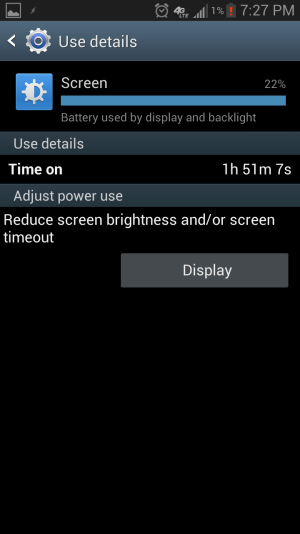

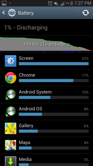

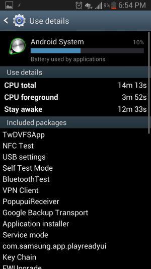

These were yesterday's stats. Horrific. I let it die and then recharge last night, so we'll see what happens today.
Please note that the third photo is not my total screen time, but I wasn't sure if I would remember to screenshot it before it died, so I took that with 9 percent left.

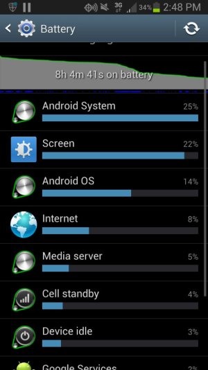

Android system is on the top of my list. Why? It's really annoying and I don't know what app is sucking up my battery. Pics attached.
