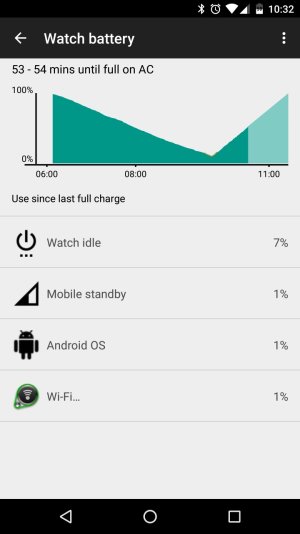

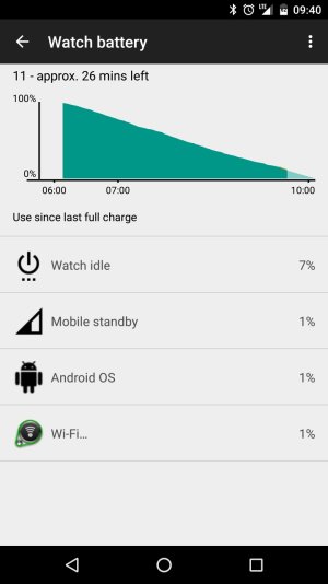

I have been using my new watch now for almost a week with sim card inside. It has been amazing from all aspects.
Even with heavy usage, battery was getting to 10% by end of the day which is fine with me.
However, today is a different story. I got up at 6 am as usual and took the watch off the charger and left it there. After nearly 3 hours, i put on the watch and went for a walk with my watch and phone.
When i got back home, i was surprised to see the battery is only at 11% although i hardly used the watch. Looking at the battery graph, i figured out that it looks like the same issue we had with nexus 5 battery drain bug. How? because when i put back on the charger, it was charging at the same speed as it was drained out. This means that something wrong is happening in the background.
I did not see anyone reported similar problem so i hope it's only a bug and not a common issue.

Did you install a watch face that has weather on it? I did and it drained exactly like that! So I removed it and I'm back to 7% an hour

No. I am using the default LG Modern watch face. Nothing special. It has been running fine since I restarted the watch.

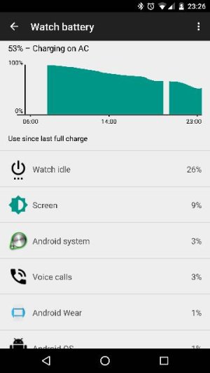

It looks like a mobile signal issue. It happened again as you can see in the screenshot. I turned it off and i had better battery life.

So I get very bad battery when I am in a low signal area. About the drain you mentioned. It looks like it struggles too much to hold signal. In a good signal area I have amazing battery life though. I am at 85% with cell on and have cellular enabled. Off charger for 4.5 hours.
