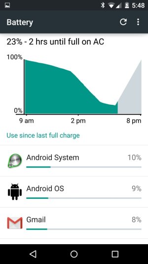

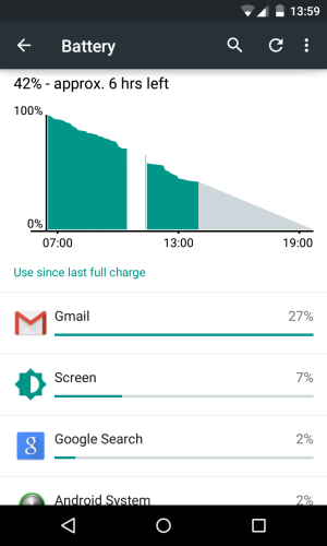

The Cache Wipe appears to have given me 2 more hours at this rate, but my screen time for today is only about 1:11, so i haven't exactly been pushing it hard. (brightness=lowest(auto)) GMail is currently contributing to 27% of my power consumption.
Willing to reset if no solution is forthcoming the the next while, but I think fixing it or identifying the problem would help more people.

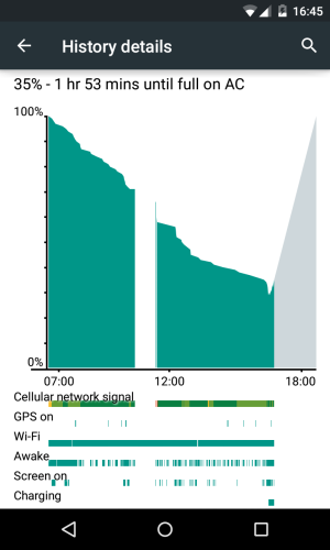

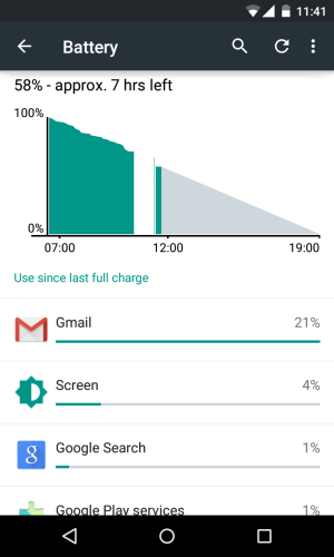

I am having a lot of trouble with my Exchange account on GMail draining the battery. I am running Android 5.0.1 on a Nexus 5.
Normally it is fine but every few days it goes wrong, the phone gets hot and the battery goes down very fast. I have a colleague with the same problem. Stopping sync on the Outlook account does not help, but deleting the Outlook account fixes it. I then reinstall the Outlook account and all is well for a few days and then it happens again. I have also tried deleting all reference to the phone in Outlook web access - doesn't help.
Here is an example. Just before 2pm it went wrong and it 5pm I deleted the Outlook account.

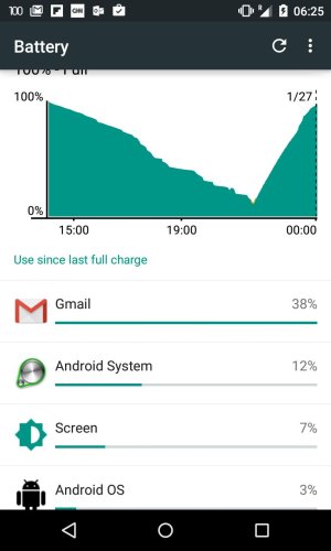

I've had nexus 4 for 2 years. Battery life not good but learned to live with it. Recently gobbling battery and getting hot. Got a new battery ted but it didn't make much difference. Looked in battery use and it said gmail using 40%. I had yahoo mail ad g mail in the email ap. I closed gmail down and got rid of the email ap. Now use only yahoo mail via its own ap. . It is like having a new phone. It lasts 4 or 5 days s on low level use. I can't believe it. I am not technically minded and have no explanation for this. I was thinking of upgrading too! I'm keeping this until there is a massive case for change. I just had to tell someone. Thanks for listening.
