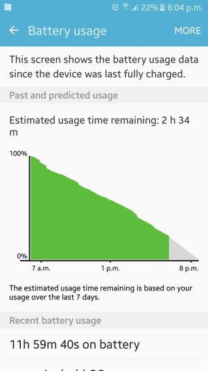

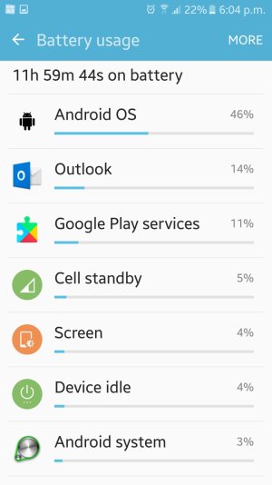

I'm not sure if this helps?
Also I have to press the home button between 2-4 times to open the phone, something dodgy going on for sure
thanks in advance

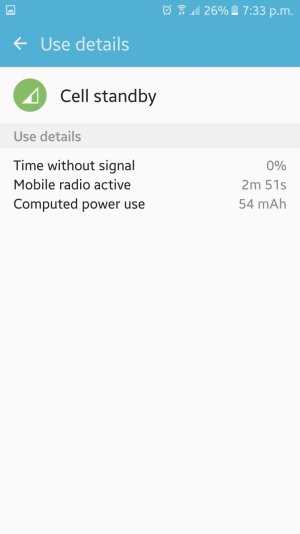

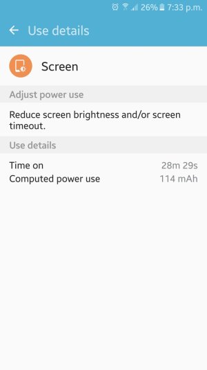

It would still be helpful to tap the Cell Standby and Screen listings, to see how much Time Without Signal and how much Screen On Time there was for that charge.

Hi sorry for late reply, been busy with work. I shall get the info uploaded. The Dr Fone was downloaded to my PC
Here's the info you asked for

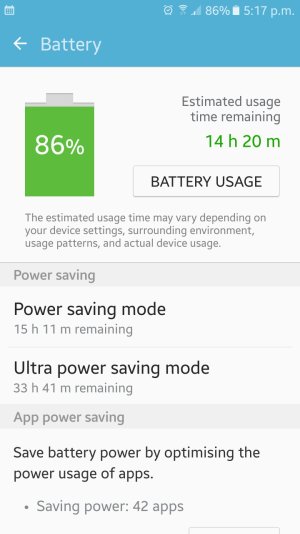

Look at this baby!! Clearing the cache worked thanks
Great! Let us know if the problem comes back (and if clearing the cache works again).
The picture above was taken 1 hour ago. Phone has been up and running for 11.5 hours, so we're back to normal. Clearing the cache worked perfectly to stop whatever was still running in the background from Dr fone. Thanks again, must dash been here 12 hours and have extra hour to go then home, one of those days lol
