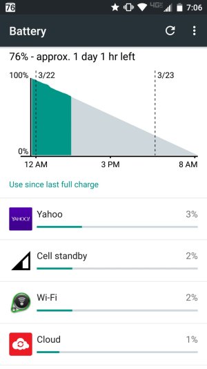

Lately my battery has been draining significantly worse when I leave it uncharged over night. I am typically losing between 20-25% each night. It used to be 5-10% when things were going good. I just cleared the partition cache on Saturday and I would prefer not to do a factory reset. So hoping someone might have some insight based on their experiences.

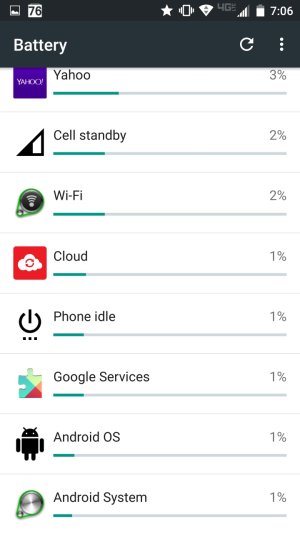

Below are some screenshots of the battery usage. I am on WiFi the whole time and I realize the Yahoo app is the biggest culprit but there don't seem to be any other big users.
Any help would be appreciated.
The display is one of the biggest killer of the turbo battery. Make sure Yahoo or like apps aren't turning your display on throughout the night. I use Moto app to keep screen off during sleep hours. I don't sync email throughout the night.

The Yahoo app isn't really draining much more than anything else, like cell standby of Wifi, so it's not exactly a "culprit". You're screenshots aren't showing enough info. Is the phone awake for long periods of time? Tap the usage graph next time and that will bring up a new screen of info, including signal, awake time, screen on time, etc.
Do you actually use the Verizon Cloud app? If not, that's a great candidate for disabling. Settings / apps, find the Cloud app in the list of all apps and tap it, and tap the disable button. (Though, again, it's not using a lot of battery, any amount for an app that you're not using can be uninstalled or, in the case of bloatware like this, disabled.)

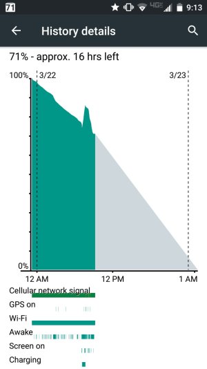

Attached is a further break down and I charged it briefly before heading in to work.
Something is definitely keeping your phone awake - you have a lot of wakelocks showing right there. Check to make sure that you don't have some rouge apps syncing in the background or what not. Try looking at your data usage and seeing if there are apps that have a ton of "background" data pulls. Usually they're the ones keeping your phone awake and draining battery.
The only big block of awake time overnight was at about 3 am. Otherwise, it looks normal. There isn't any screen on time (so the screen isn't turning on without being used) and location services are practically nothing. The period after you awoke was fairly normal - awake while charging (as expected) and a large block of awake time with screen off just before you took the screenshot - were you listening to music (or other media) or talking on the phone with the screen off during this time? If yes, that's expected awake time, too.
