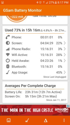

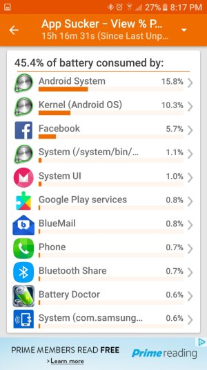

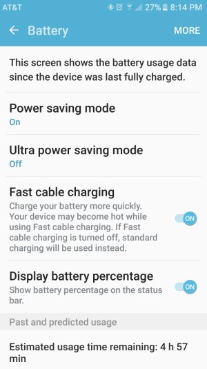

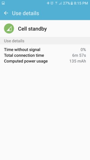

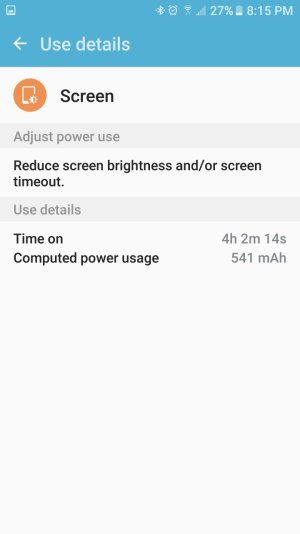

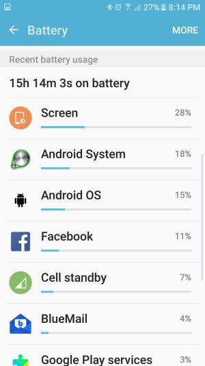

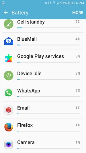

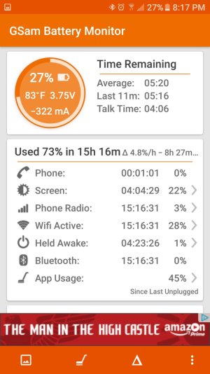

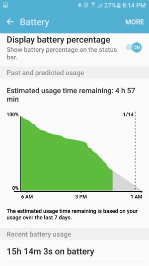

Hello B. Diddy, others. Thanks to all for your help. After having the battery drain issue the other day, I have monitored the phone for the past two days on an almost hour-to-hour basis. It has been my regular use. The battery drain issue seems to have stabilized a bit after I let the battery drain almost to zero a couple of nights ago and then had a full overnight charge. For two days, as per B. Diddy, I have not charged during the day.
On Thursday, I monitored 7am (@ 100%) to 10pm (@ 37%) for an average of 4.2% drain p/her.
On Friday, I monitored 5am (@ 100%) to 11pm (@ 16%) for an average of 4.67% drain p/hr.
It still seems to be more than I had been accustomed to, but not the 7 - 10+ p/hr that I had been experiencing a few days ago.
I am attaching some screen shots that I took last night. I hope they help B. Diddy.
Thanks and blessings to all.

Thanks for the screenshots! Overall, I'd say your battery life isn't that bad. 4 hrs of screen on time with 27% battery left is pretty decent, and if you were to use it down to 0% (which you shouldn't on a regular basis, by the way, if you want to preserve your battery's overall lifespan), you'd get upwards of 5 hours.

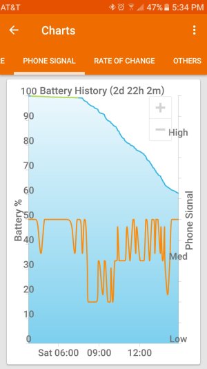

Cell Standby is still somewhat high, and even though the Time Without Signal is 0%, that doesn't mean that weak signal isn't a problem. You often have only 2 bars in your cell signal strength indicator in those screenshots, so I suspect that weak signal is still an issue. GSam Battery Monitor has a graph that shows your cell signal superimposed on the battery level -- can you show us that?

Thanks for the response and the knowledge, B. Diddy. I hope this is the screenshot you need. Poor signal strength has always been an issue while at home. (I spend a lot of time working out of my office at home.) Three bars are very rare here, and one tiny bar is common.
Let me know what you think.

Pretty mediocre-to-poor signal, I'm afraid. I'd say that overall battery life you're having is pretty good in that light. What carrier do you use? Do they offer signal boosters for the home? T-Mobile offers them for free (at least for postpaid customers).

Thanks, B. Diddy. So, I understand that you think that the signal issue is the probable culprit, but that battery life is not that bad given the signal strength. Phone had 100% at 8am and 35% at 8 pm, but there has been limited use. My carrier is AT&T.

That's correct. I actually wouldn't call 4 hrs of screen-on time light usage -- that's more like moderate.
