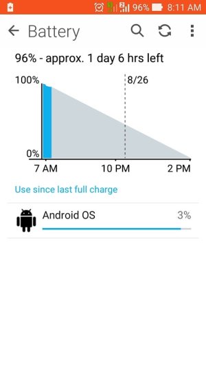

Hi,
after some update, my Zenfone 2 eat a lot of battery.
The android os is taking 4% per hour, without using any thing, wifi off, 3g off. Can you advise?
Android OS is using only 3% of the total amount used? I want my phone to do that, I'd even be happy if it used 10%. 15 hours to 40% (or approximately)? That's something some people would kill for.
(That's not 3% per hour, that's 3% of the total amount being used by the entire phone since the last charge. It's usually between 15% and 30%, depending on the phone. Most people are happy to get 8 hours on a charge.)

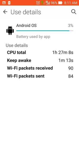

Hi Rukbat,
I charged to 100%, just turn on my phone for 1h20min, did nothing, and the OS consume 3%. Only standby cost you 3% per hour. the phone will not last for 1 working day.

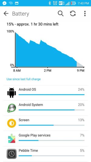

Android OS battery drain has been a persistent issue on this phone. On my Zenfone 2, OS always ends up using 30-40% battery by the end of charge, and the phone usually loses 2-3% per hour when idle.
I don't think this is a Lollipop problem, because this never occurred on my Nexus 5. I think it has to do with the Intel Atom processor, because if you ever look at the core usage, you'll see that none of the cores ever seem to go idle. Even when the phone is idle, all 4 cores are working, usually at 500 Mhz. This doesn't happen with the Snapdragon on the Nexus 5. I'm guessing that this leads to the kind of drain we experience.
