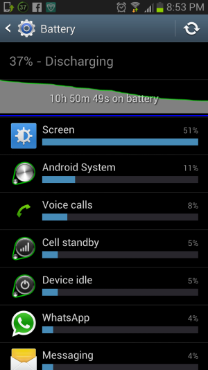

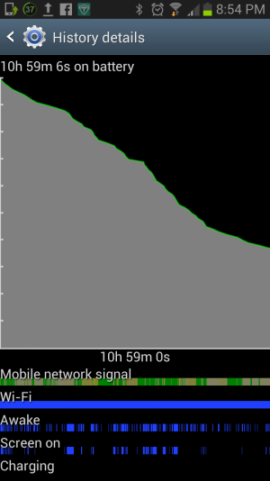

kray86,
Try to limit the double posts.
And as noted in my other reply, we also need the Screen on detail for a complete picture.
Sent from my rooted, debloated, deodexed Sinclair ZX-80 running CM 10.2 using Tapatalk 4
click on the screen option (in your screenshot it's 51%) that will tell you the screen on time. Then take a screenshot of it.
