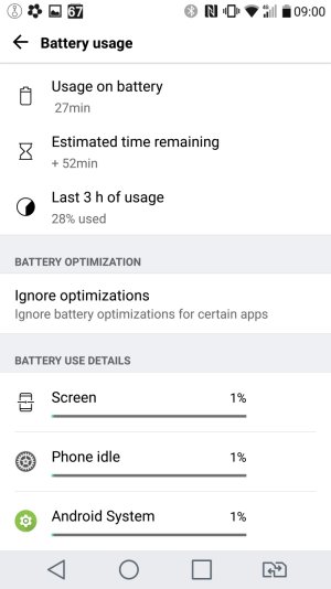

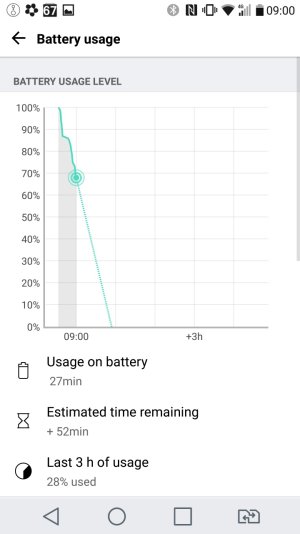

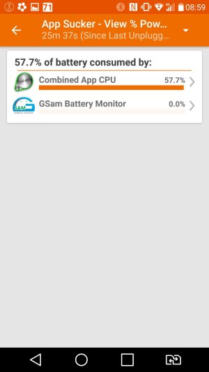

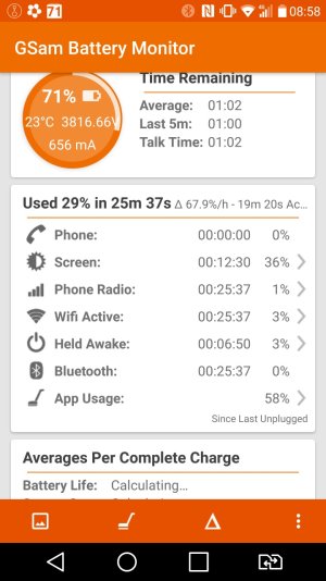

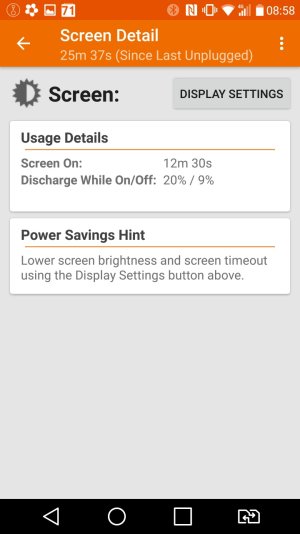

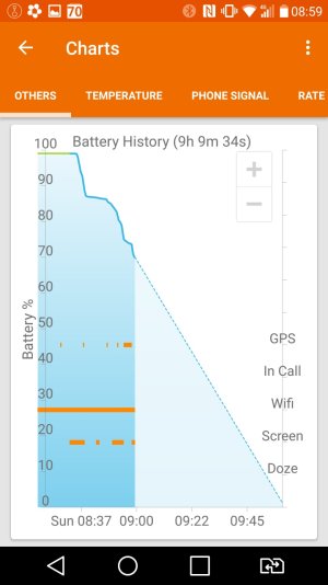

Ive attached a few screen shots. Are these the ones that you were looking for? Does that tell you anything?

One of your apps is causing the drain which you won't know which until you use the adb commands in the gsam battery app to enable it to see each app separately

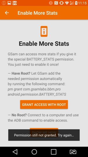

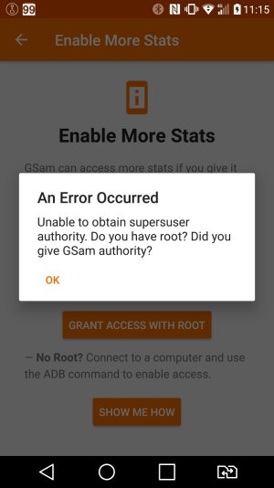

Hi,
Im getting this error when trying to enable more settings.
It doesn't matter that much, but you had Bluetooth turned on for almost half an hour, and radios do use a bit of power. But I'd suspect that it's just time to replace the battery.
